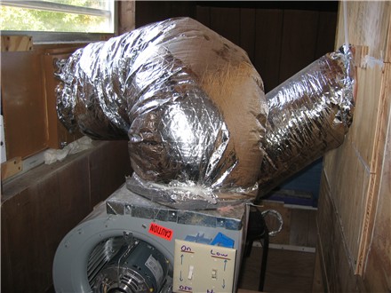

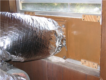

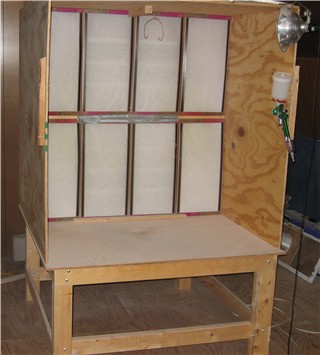

My spray booth is a 4’x4’x4’ plywood box. I have two layers of filters in the back of it. Behind the filters I have a pipe that goes to my blower. That’s what moves the air. A squirrel cage blower that’s built for paint booths. I have the exhaust pipe from the blower going into a thing I built that’s fitted into a window. It allows me to open and close a door which cuts off the air flow. Hope some of that makes sense.

Here is a few pics of my spray setup. As long as there is a little airflow coming into the shop from an opened window or something it works great. It would be impossible to have a spray booth setup that worked properly without having any outside air coming in with a small shop. It took me a while to learn that.
If you have any questions just ask.

Cool setup Colby! You got me thinking and I think I might just build one like that myself. I have a explosion proof fan that I got at a yard sale for 10 bucks a year or so ago, just need to build the booth and a window insert like you have.
BTW, do you just use furnace filters in yours? I was wondering if that would trap most of the solids that were headed outside.

I do use furnace filters in mine. I use to layers. Eight on the back layer and eight on the front layer. It takes 16 filters all together. They seem to trap most of the finish and just blow out the fumes. After a few spray sessions I take these outside and blow them out with my air compressor.

If you have a good squirrel cage blower I don't see why you would need another fan. The blower has air intake on the side (I have this pipe going into the back of the booth) and the air exhaust is on the top (this pipe leads to the window). I'm not for sure about all the explosion proof issues I just know my is because it's built for this kind of use. I think most blowers like this would be safe though.
